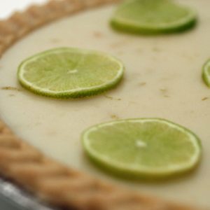

Earlier this month Chad mentioned that he wanted key lime pie. And if you say something like that around me, you are going to get a key lime pie. Especially if you keep repeating it and staring at me. And following me around. So yeah, he got a key lime pie, or something like that. I don’t know where to find key limes right now, and those are too hard to zest anyway. Regular old limes worked just beautifully.
You can see that I used a store bought crust here, but when I am experimenting with a new recipe that has temperamental ingredients like agar, I don’t want to waste my precious energy on making a crust. Don’t judge me. Luckily, it worked out with the first shot. If it hadn’t I was planning on pieing someone with it. In any case, a graham cracker crust would be great choice, too.
The texture resembles a creamy panna cotta. There’s no tofu here, it’s a coconut milk base but the coconut flavor wasn’t strong enough to warrant a title change. The flavor is pucker your lips tangy, and will definitely satisfy the lime lover in your life. Remember to zest your limes before squeezing out the juice. It took me 8 small limes to get the right amount of everything, your mileage my vary.
